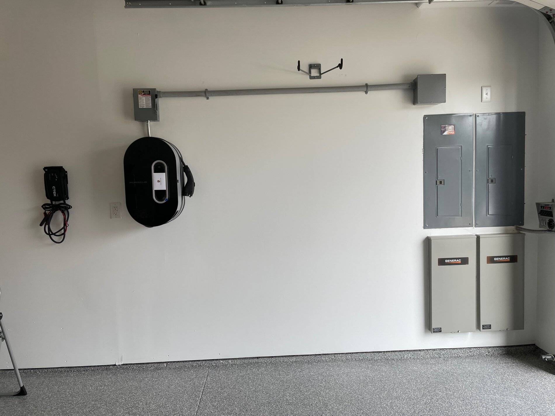

Setup 1 complete. Setup 2 in works. All while having no car (still haven't taken delivery) - steering column module arrived today and was installed. Keys from Germany still not here. Re-ordered today directly from Germany since no ETA from Atlanta distribution.
50 AMP circuit breaker on panel
#1 AWG gauge copper wire to 60 AMP rated safety switch
#6 AWG gauge copper wire to Hubbell HBL9430A 14-50 Receptacle (tried to go #1 or #3, but it wouldn't fit in the docking station spacer)

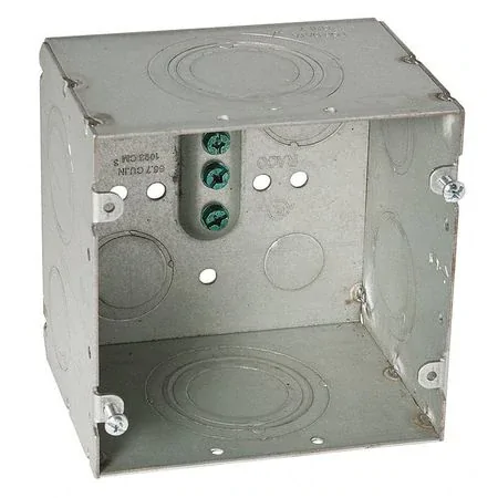

RACO 2-Gang Electrical Box 4-11/16" x 4-11/16" x 3-1/4" (huge, ample space for wires)
Cover: https://www.zoro.com/raco-electrical-box-cover-30-60a-receptacle-888/i/G3275903/

BTW safety switch is overkill - given the panel is just a few feet away.
#1 AWG is overkill, I blame @daveo4EV for the idea=)
This should compensate for my overheating PMCC with a plastic box that helps it retain even more heat. ?

Turning down the charge current will reduce the heat in the enclosed (but pretty) PMCC wall box. But should you ever decide to upgrade to a 350 kW DC fast charger in your garage, at least you know that #1 AWG will still be overkill.

Exactly - this makes it easy for me to upgrade in the future.
I figure I give the PMCC a chance and then if not, I will upgrade the safety switch to 100 amp rated and can use a #3 AWG wire down hardwire the next EV charger.
Most the work was in wiring the #1 AWG copper to the panel. The difference between a #1 and #6 wire is visibly noticeable!
I do like the wall box.
AWG 1 is overkill for any Level 2 charger, unless you're running it for hundreds of feet (probably even then). My 80A charger on a 100A breaker recommends AWG4 or AWG3. I ran AWG2 and the government inspector who came to inspect the installation still called my solution "over-engineered", but of course passed it no problem. I also added a 100A safety switch, which he told me was not needed since the breaker counted as one (to be honest, I am still not certain whether every inspector would agree, my reading of the code says I need one).
All that said, I like over-engineered solutions. Thinking about starting a company with some niche products and a slogan along the lines of "Over-engineered - for when you want it, even if you don't absolutely need it". :cool:

AWG 1 is overkill for any Level 2 charger, unless you're running it for hundreds of feet (probably even then). My 80A charger on a 100A breaker recommends AWG4 or AWG3. I ran AWG2 and the government inspector who came to inspect the installation still called my solution "over-engineered", but if course passed it no problem. I also added a 100A safety switch, which he told me was not needed since the breaker counted as one (to be honest, I am still not certain whether every inspector would agree, my reading of the code says I need one).
